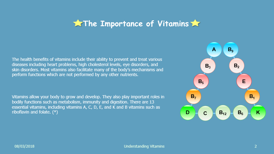

Basically, a footer appears at the Slide Footer area on a slide. A Slide Footer area can include three placeholders: Date, Footer, and Slide Number. You can insert footer elements (date, footer text, and slide number) into these placeholders.
Here is an example of using a footer in a presentation.

Then, you see the Slide Footer like the below screenshot.
